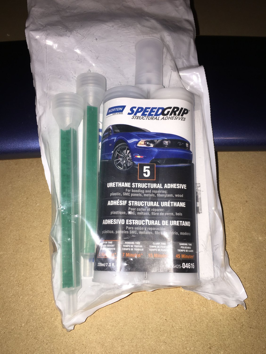

you are 100% correct about the wing composition. Foam core and gel coat
i snapped an an image prior to my repair
