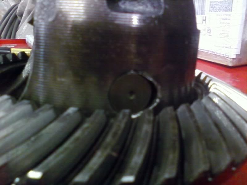

Originally Posted by daithi2
Looks like she was on her last leg
Rear was full of metal Shavings and all the bearings are shot.
Wow, how many miles on that diff? Run hard?
Old Jul 9, 2011 | 11:50 PM
  #970 (permalink)
daithi2's Avatar
Posts: 193
From: Amarillo, Tx
Default Re: *Needed* 20 to Pre-order Wavetrac LSD for SLK32/SRT-6
32,000 miles. Around 600 passes at the track. Most of those spraying out of the hole. It had quite a bit of play and the spiders locked up a couples times.
As many problem I've seen others have had I'm suprised it lasted this long.
Was/is the keeper roll pin missing or sheared on that shaft? It was really wallowing out badly....

From: Amarillo, Tx
That's how it came out. The rest is just metal shavings.
