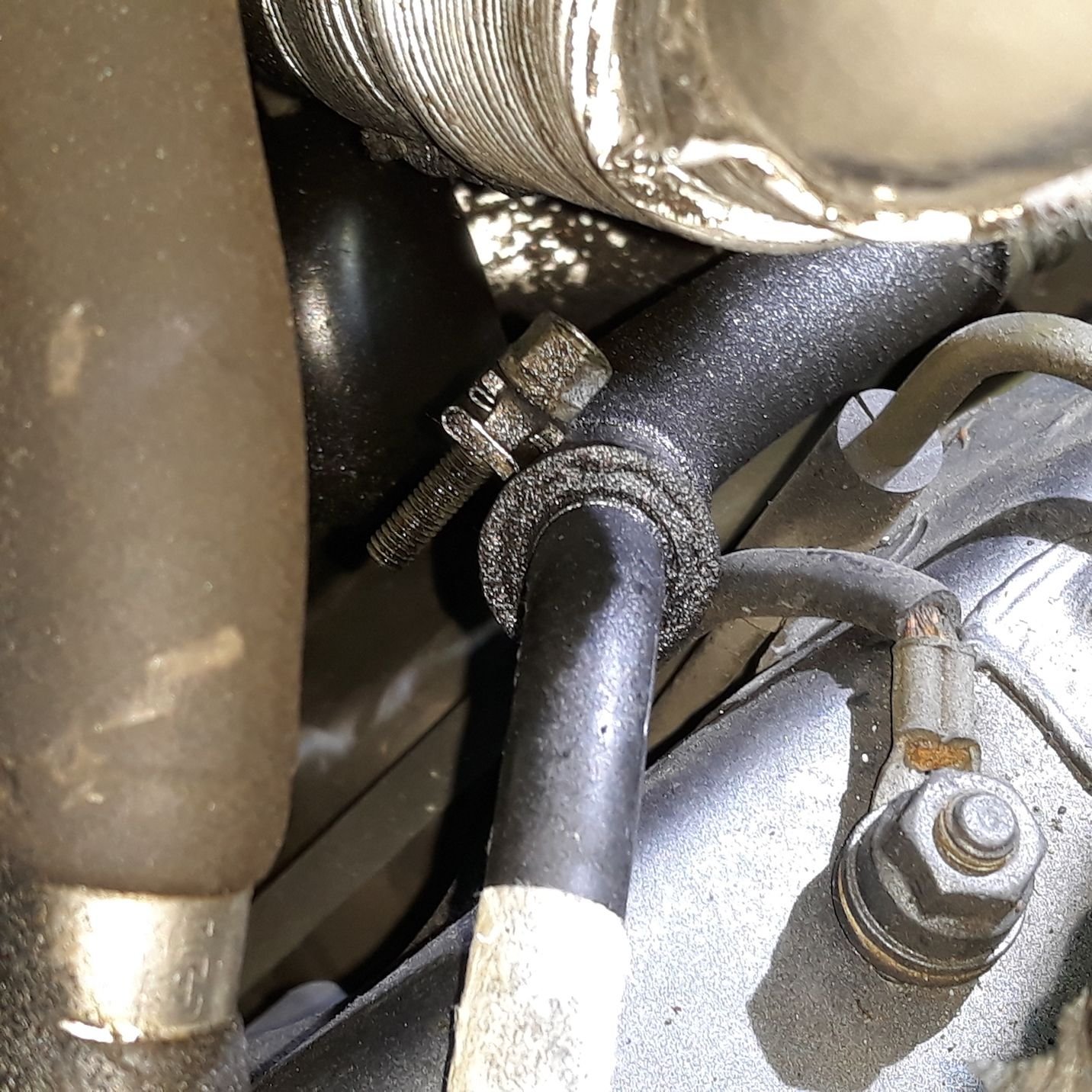

I've had my 2006 Crossfire a little over a month now and have a "non-visual" leak. When I come to a stop is when I smell a burnt oil on exhaust. The valve cover gaskets are new and show no signs of leaking. I see no tell tale splotches on the exhaust manifolds where oil might have dropped anywhere under the hood. The only slightly oily residue I see is where the transmission line hooks to the steel line going to the cooler. That may or may not be the problem but that's all under the exhaust and I don't see a way of it getting to the exhaust. Just the same I'll put a new clamp on the line. Any ideas would be appreciated.
When I get a chance I'll jack up the car and see what I can see under the car.

To the OP, that first line you showed in your pretty is your power steering line, they all leak a little like that. I would even call it a leak, mine looks the same. If you have oil on your tranny or where the black 2 inspection covers on the bell housing of the trans is that is most likely a rear main seal and will require you to drop the trans to fix. That's a 1k job at minimal. Mine's has been leaking for years and I haven't replaced it. I just wipe it down every few weeks, this is only on this motor and trans. If you visit the Mercedes forums you'll see owners with the m112 talking about rear main leaks.
Good information about the chime. I'll try your suggestion about wiping it down every so often. So far it doesn't have any drips on my driveway. If I get a chance tomorrow I'll jack it up and wipe it down. Thanks
