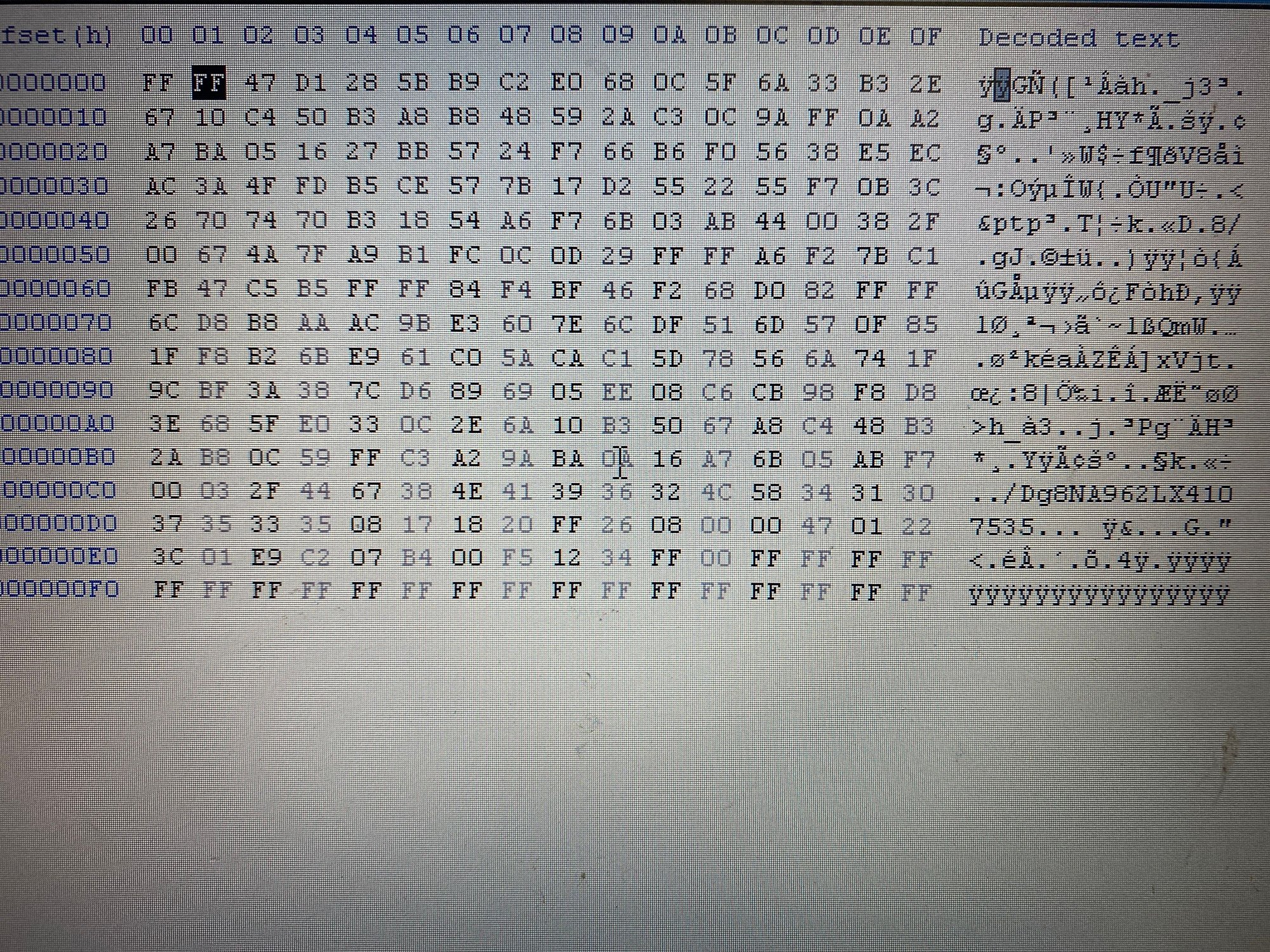

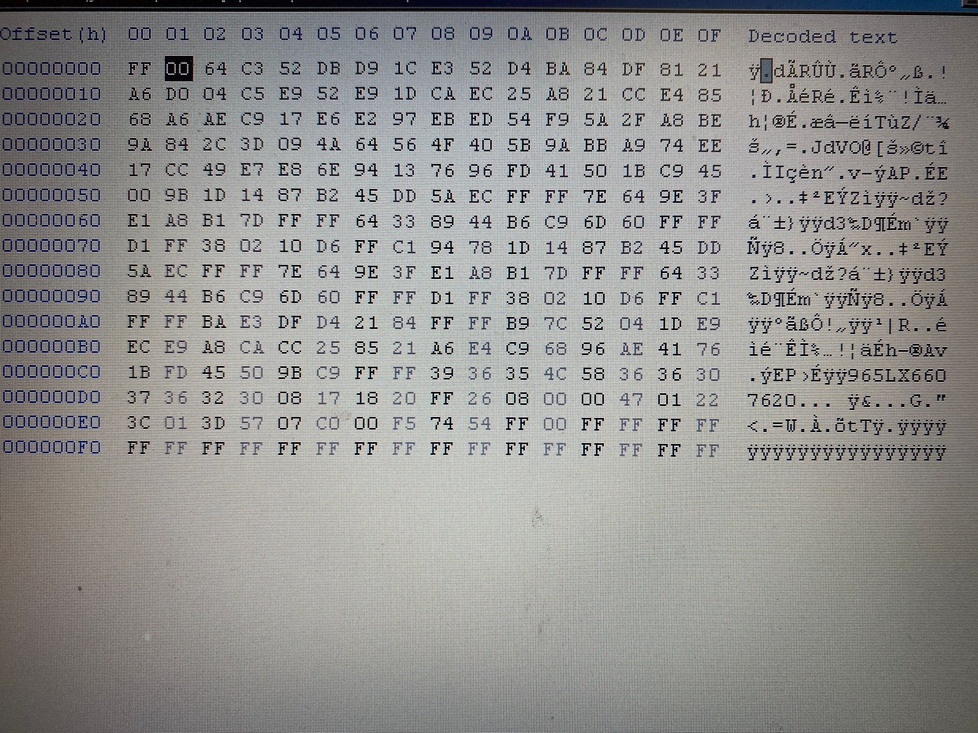

viper, please reread xfFreChris's post. The rfid chip is the one from INSIDE his original key. He asked if he swaps the rfid chip into a different FOB, with his original key blank, it will work. Just linking it to the car lock/unlock/alarm is needed since it is the rfid chip from his original key. I saw nothing about him having a different SKREEM in the car. If he has a damaged FOB circuit board, he will have to use the key to lock/unlock but as soon as he inserts the key in the ignition with the original rfid chip is in the FOB, the car WILL start. That circuit board in the FOB is only for the REMOTE lock/unlock & alarm function. There are a number of xf FOB's around that can be used to replace the FOB circuit board so he can have the lock/unlock/alarm function back (a complete working key FOB). All he has to do is make sure the key blank, rfid chip from his broken car FOB, and the circuit board in the replacement FOB case and he'll have a whole key that works.
Old Jan 19, 2021 | 03:03 PM
  #211 (permalink)
sk8erjosh09's Avatar
Joined: May 2011
Posts: 2,192
Likes: 24
From: Ridgecrest, CA
Default Re: Let's discuss the key fob transponder chip(s)
Originally Posted by Viper-666
I think it should work if the data on the EEPROM of the damaged board is not deleted and you solder this EEPROM to the other board. But I don't know if this really work.
It doesn’t. That was the first thing I tried over a year ago. The 93C56 has what looks like a cut/chopped/adjusted VIN that is 12-14 digits. If you transfer the data from one to another it does not work. That doesn’t mean whatever goes wrong is in that eeprom, it could be data specific between the processor and its original eeprom and therefore conflict (not work). All of the data is different between one and another. Here’s an image of a readout:
Here’s another:
Here’s one way to do all of which we’ve been trying forever: Link
However, I need to do this right now lol. And much cheaper so I have decided to share all of this in hopes that we can really figure this out.
I have more info if anyone wants to know, just ask.
