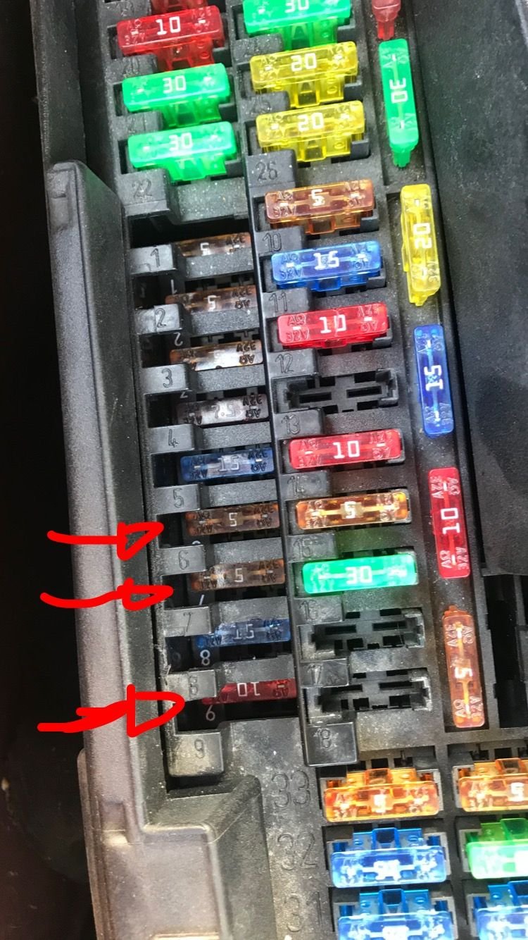

I’ve taken a picture of the fuses and put a arrow to the 3 which are blown
I’ve already removed the panel under the trunk lid and connections seem fine that’s as far as I’ve checked... if the issue is the pump which has died would the manual button on centre console still light up red when pressed?? Because if that’s the case and the button should still light up even though the pump has failed then it’ll mean the issue isn’t the pump itself and I have a problem somewhere else

I don't know what year your crossfire is so I cant help because the fuses do vary base on year model.(there should be a card on the top you removed that will tell you what the fuse controls).
I see that one of them is the fuse # 9 I mentioned above. The buzzer in these cars go bad and blow the #9 fuse. That is why I asked you to roll the windows down and then open the car from the inside. Note again if buzzer is good be prepared for loud alarm and have others be ready too.

I will have to research what 6 and 7 do. Like I said there are really great people with way more knowledge than me on here.

Fuse 7 could be your BCM. Here is a tread link to others that have had weird issues with it and where to maybe purchase a new one.
https://www.crossfireforum.org/forum...tml#post447032
Fuse 6 says it controls the mirror movement left and right on a coup I dont know if that goes through the BCM or not. Its located on the passengers side under the hood by the fuse box you took a picture of.

as you can see from the picture I’ve attached above showing the blown fuses it’s the number 10 and 5 fuses
tomorrow I will undo the cover under steering wheel and check the sensor/relay if it makes a clicking noise when the seat button is pressed
As it’s 2 fuse numbers 5 and 10 I’m guessing one is for seat electrics and other for spoiler?

my car is a 2004 coupe
I got a picture that had three arrows pointing to fuses 6,7 and 9.
I will say now your buzzer is bad If fuse 9 is blown try replacing it (and do the same thing with the door) happens a lot and a great thread here to replace repair the buzzer.
If you replace fuse 9 and the siren works then you know but if it blows the fuse again Id disconnect the siren and see if fuse 9 blows again after you replace it.
fuse 5 is your radio and fuse 10 is your speed control.
I edited my last post to have more info on BCM issues.
Hope I helped
Hope I helped
thanks for the info so basically fuse 9 is the buzzer.. I don’t understand how the fuse for radio is blown as the radio still works fine so that doesn’t make sense 🤷‍♀️
as you’ve said fuse 10 is speed control I’m guessing that’s the spoiler? Can you clear one thing for me if the spoiler motor is blown does the manual spoiler button in centre console still flash red when pressed? As mine does nothing when I press the manual button no light

Be sure you have the correct fuse diagram for your car. Not all fuse locations are the same on all crossfires. Was there a fuse diagram inside the fuse box?
yes completely understand but I have no fuse diagram in the fuse box... my car is a 2004 coupe with manual gearbox
Old Jun 1, 2021 | 04:45 PM
Likes: 650
Default Re: Spoiler has no power and electric seats don’t work.. HELP 😭
The 2004 Owners Manual has the diagram of the fuse layout. You can download the Manual on this forum. Look for the Documentation thread, it is a sticky.
You should also get a copy of the 2004 Service Manual downloaded to your computer for help as well, it is in the Documentation thread as well.
I downloaded your manual and let’s see if I can clarify my comments here.
I think you are mistaken on the fuse numbers you have the arrows by on your picture.
when I look at the picture I see fuse 6,7and 9 with arrows beside it.
by your manual 6 controls your mirrors, 7 is bcm and a few other items.and 9 is buzzer and dome light and a few other things.
that’s why I would start by pulling the BCM and opening it up and check for corrosion and the solder connections. If it looks bad please refer to the link I sent earlier to get it repaired.
Id also pull the buzzer replace fuse 9 and see if it blows again if so we have a short somewhere else.
again just trying to help.
We do not call it a buzzer, it is an alarm or a siren. People added buzzers from Radio Shack etc. before the chirping alarm was introduced to the members here.
The BCM should not be damaged my moisture it is high under the hood and well covered.
Thanks for the information
so fuse 6 is mirrors
fuse 7 is BCM
Fuse 9 Is buzzer
someone else on here said fuse 9 was speed control but anyway you said fuse 6 is mirrors but both of my mirrors are working fine? 🤷‍♀️
either way first things first I need to remove the BCM and have a look at that from inside
fuse 7 is BCM
Fuse 9 Is buzzer
NO NO NO The first thing you need to do is take the windshield wipers off, remove the plastic cowl that runs under the windshield and you will see the SIREN ( STOP calling it a BUZZER) and disconnect the damn siren!. Insert a new fuse nine and start your car. You can run around forever without the siren connected. Many of us do just that. It will not effect anything else, but it does eliminate some problems. you just won't have a security siren/alarm.
While you have the cowl off, clean out the four drains which allow water to run down and out the bottom of the car!
